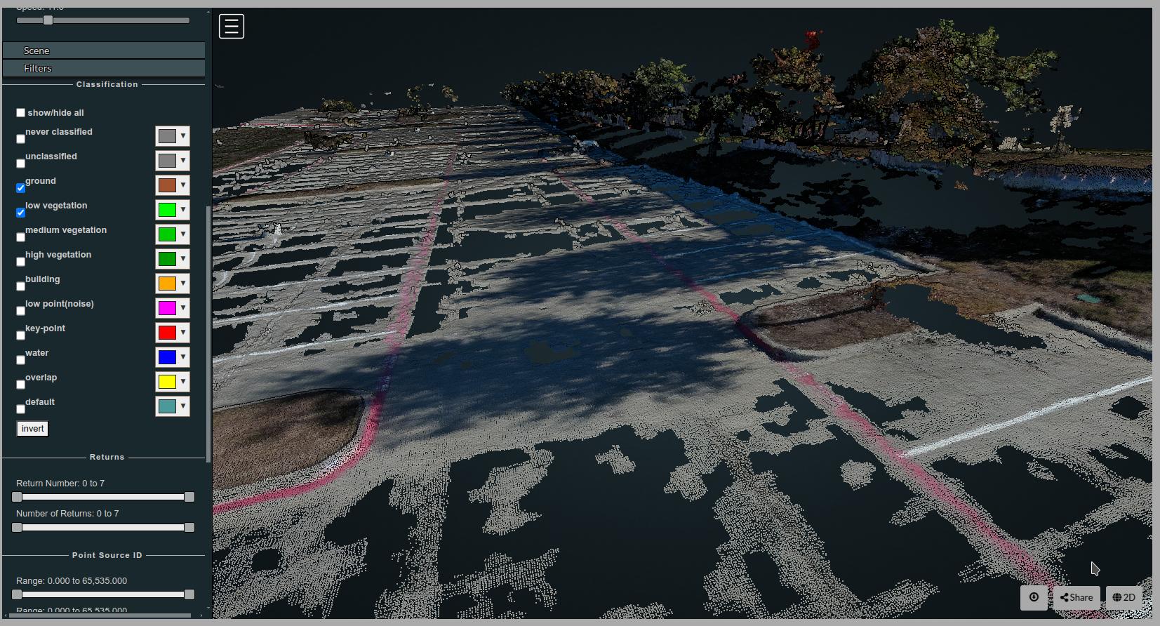

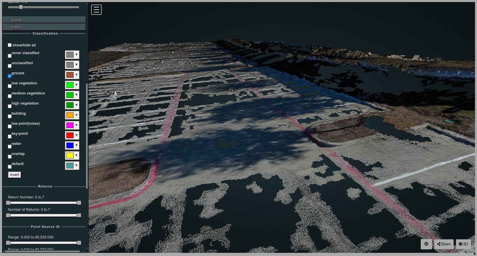

Hey All,
It’s been awhile.
Please review the attached very short video. Since the 3D viewer already somewhat classifies point clouds under Filters, is it possible to download just the ground classified 3D point cloud? This would save so much time when additional cleaning is required in CloudCompare. Hopefully, I am just missing where this is done.
Regards,
Gerry
The point cloud has a classification attribute. You should be able to filter the non-ground points directly from cloud compare (if you’ve processed the dataset with either --pc-classify and/or --dtm).
Thank you. I’ll take another look.
Gerry
