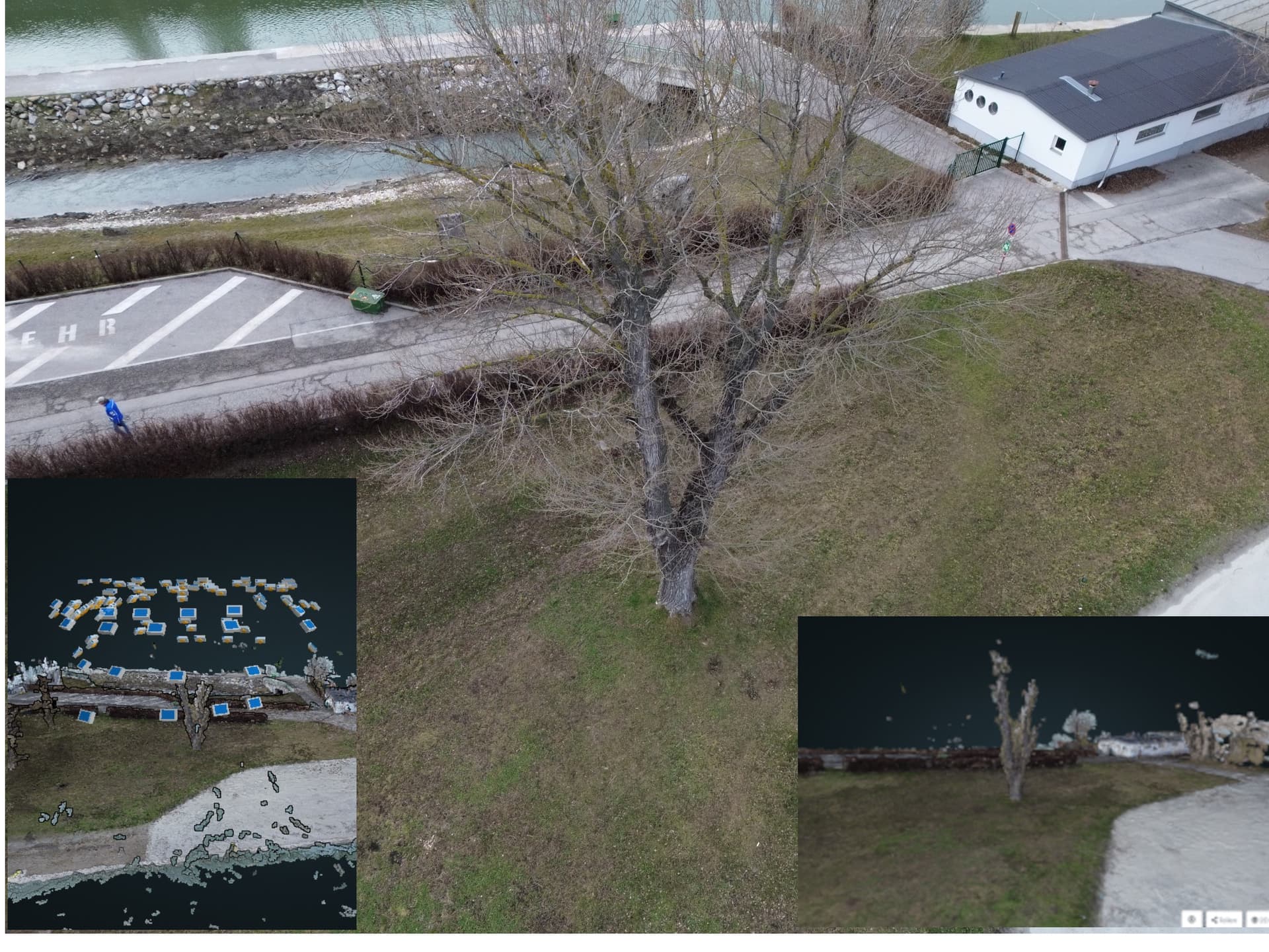

im pretty new with webODM and i am trying to make 3d models of trees. with the current pictures (±100 pictures) i take, i always end up with a model with just the stem without the branches.if someone has any tipps how to generate the full model i would thank you. In the picture u can see the model i end up with and how the tree should look.
the options for the 3d model are: auto-boundary:true, mesh-octree-depth:12, use-3dmesh:true, pc-quality:high, mesh-size:300000
thanks for ur help
My guess is this:
When looking at the smaller branches and tips of the tree, you also see the background (grass, road, etc) in your image. As the branches get smaller, the background becomes more dominant and also changes with each camera position. This could result in fewer points to match.
Thanks Sam. Maybe it works if i also take pictures from down to up so the backgroud is the sky
Its worth a ‘shot’.
