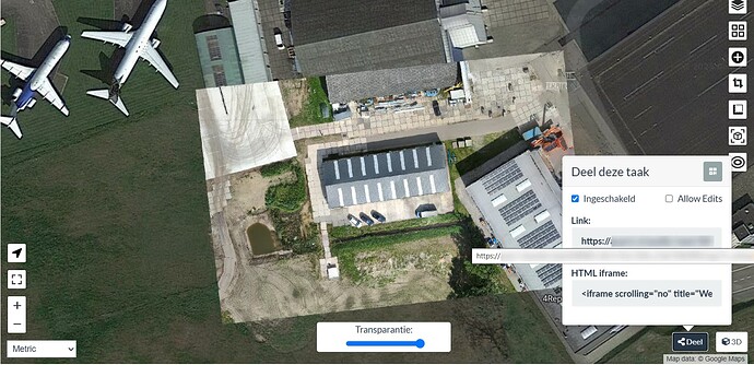

If you process the images on a local computer you can’t (it is a local installation, just your computer)
If you process the images on a self hosted server / WebODM Lightning you can, via the share button.
