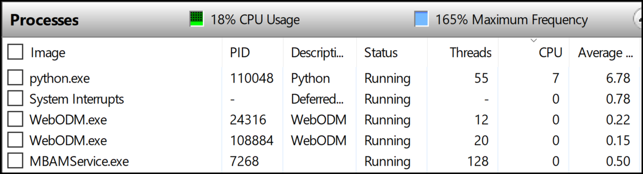

If I look at system resources, not much memory is being used and disk access is pretty low, with most or all of the processes doing disk access being unrelated to WebODM. CPU usage is also relatively low, running at about 17% with regular spikes into the mid-20s. This screen capture is sorted by descending CPU usage:
The top process is consistently python.exe, using 7% with occasional 6% and up to 9%. There are 7 python.exe processes, but only this one is getting any CPU time.
One postgres.exe process is showing quite a bit of network activity, along with a couple of python.exe processes, but I haven’t determined what they are talking to.
I would expect the image matching to be CPU-intensive (but what do I know?). Since I’m only seeing 7% CPU usage on one python task, and overall my system is not what you’d call very busy, I’m surmising that only one matching is actually going on at a time.
