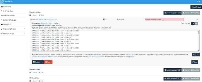

Running WebODM on the virtual machine installed on Ubuntu 16.04 using Piero’s script. That VM has 320Gb Drive and within 4 projects managed to run out of space. Deleting old project pictures (Administration - Application - Image Uploads - Change) didn’t return the space back. Any advise would be greatly appreciated.
So just an information that could help with diagnostic the problem: I have deleted all projects from the dashboard and got all the space back. I am having difficulties to believe that this is normal behavior to use 300Gb for projects that total under 1000 pictures.
