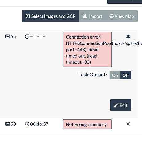

OK, found the Task Output screen at the upload window, suggested upgrade RAM, use a different node reduce number of images and/or alter image size. Just working through these.
Is there any documentation about recommendations for these items - ie - “uploads are usually limited to about 60 photos at x size, to upload more you need xGB of RAM etc”?
Also created a Lightning Network account.
55 images on the Lightning node.
If you can, I’d try maxing out the RAM with an upgrade. You’re not going to be able to allocate much more than 4GB to docker and keep the host OSX stable, so pretty insufficient.
Lightning interruption does happen, but normally only over wireless links with spotty quality.
Are you able to wire into your network?
Thank you for this, time has flown but I have tripled my Mac’s ram and connected via ethernet to the network router. I am working through the documentation now.
