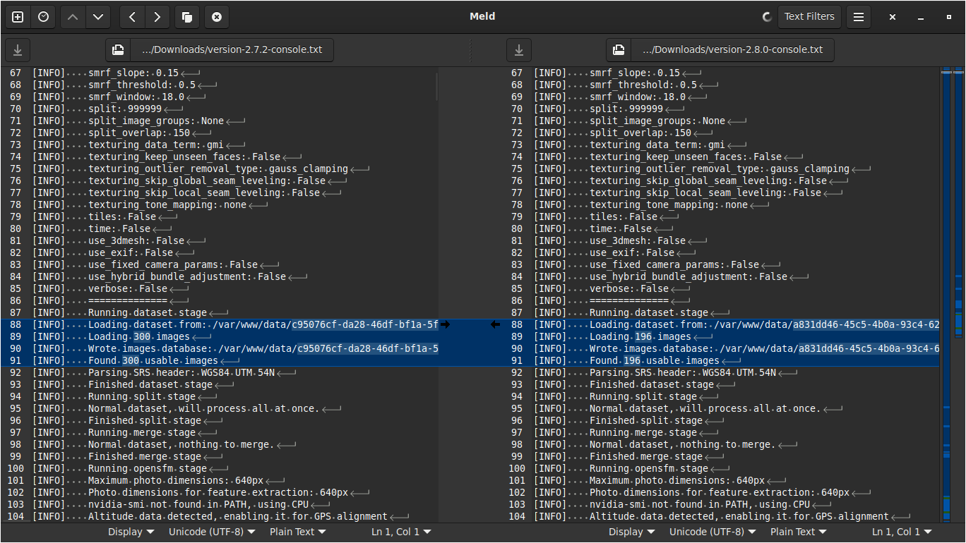

Can you please post your full processing logs for both v2.7.2 and v2.8.0?
I’m wondering if your instance is using the GPU feature matching/extraction or not, or if something else is going on.
Here they are
I think we may have found our culprit…
300 images in the dataset processed under v2.7.2, 196 images processed under v2.8.0.
Less images means you’ll likely have to push the various quality settings higher, like I did, to get the same quality of reconstruction.
I only used 196 images in Windows WebODM, with ODM 2.8.0
Yep! And both you and I pushed a number of important quality and feature/matching parameters much higher, which likely compensated for the lower image density compared to the 300 image dataset.
