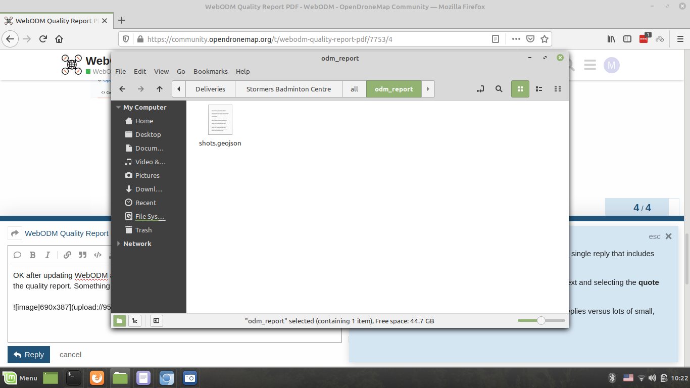

OK after updating WebODM and rerunning the task - even with the default build - I still don’t get the quality report. Something is not right!
What are your processing parameters?
Can you attach your full processing log?
Problem solved. I figured that quality report is only available when you do have DTM/DSM marked in processing parameters. Did that and also switched back on a Windows10 machine and its all good now. Thank you everyone always a pleasure working with WebODM
