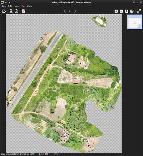

I am seeing the Orthophoto just fine in your export:
If you are trying to use a normal Image/Picture viewing program to load it, please be aware that a GeoTIFF is not a picture, but rather Raster Data, and it is best viewed using an appropriate tool, like QGIS.
