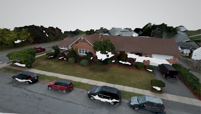

I have been working with WebODM for a few months now trying to perfect a few things. For the most part I have a good handle on tweaking settings to generate outstanding orthophotos with excellent results. However, I am having a difficult time getting that perfect 3D model. I have uploaded my photos to an online service and they seem to generate a very acceptable 3D model (viewed below and also link to online model) but I cannot seem to replicate their results in WebODM. I know that WebODM has the ability. However, I am just not finding the right combination of settings to get the same acceptable results. I always seem to get a few areas around buildings that have holes in the 3D textured model as illustrated in the attached photos. I was hoping someone on this site may have a solution to my dilemma. The model I am working on is a simple 86 image project that I can provide access to the images in case someone thinks they can overcome the obstacles that I have run into. I would be interested to know if it is just a simple setting that I am just overlooking. Here are the processing parameters in WebODM for the model created so far:

WebODM 3D textured model results image:

Try increasing mesh_octree_depth (11) and depthmap-resolution (2000), but don’t expect to replicate Altizure’s results. They use different methods to obtain those results.
Also: set camera_lens to brown and you should get very favorable results.
Thanks and I appreciate your reply. Between your suggestions (Change lens type to Brown) and Pierotofly’s ( mesh_octree_depth (11) and depthmap-resolution (2000)) the results are getting better but I am still trying to remove those few white gaps then I would be satisfied. Everything else looks great. See below.
Look at your terms above: it looks like (and these are likely defaults) you are choosing not to fill these spaces. Piero will likely have better tips than I on these, but I would try (in a few iterations):
texturing_data_term: area
texturing_keep_unseen_faces: True
texturing_skip_hole_filling: True
Those gaps are there because no cameras are able to see those parts of the mesh.
You can fill them with texturing_skip_visibility_test, but it’s generally not recommended to turn on that option.
Thank you. I have tried the texturing_keep_unseen_faces: True and that helped a little. I will try the other two suggestions…one at a time… Thank you again!
