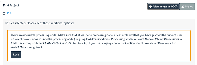

As I mentioned before, the error message confuse me.
There is no available Administration > Processing nodes menu
Also checked Processing Nodes > node-odm-1, but I don’t find Object Permissions menu.
The correct one is Processing Nodes > node-odm-1 > edit > Object Permissions.
Accept all permission but problem still exist, problem is not solved

unfortunatelly, it doesn’t work because WebODM can’t use processing node. It totally unable to process anything. The problem occurs after I updated ODM to the newest one as stated by that github thread
