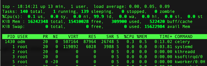

odd I didn’t shut down, but now after killing that PID, the celerybeat seems fine and doesn’t shutdown anymore. But I’m still in the same status as before:

Is there anyway to see the progress of this or if its really happening? Because right now at least from TOP it seems that things are pretty idle…
