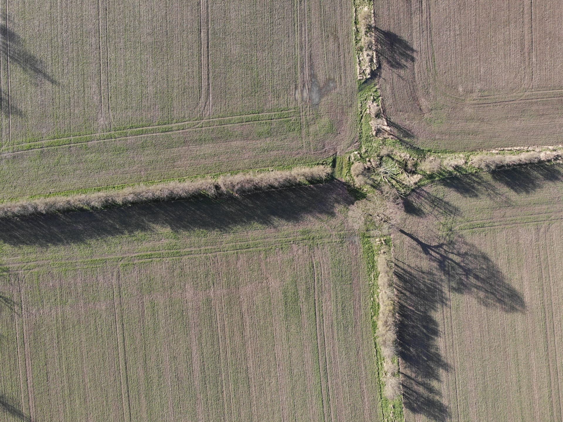

Can you post a few sequential images (might need to scale them) covering the corner on the right?
Hope this will do…
Are they from around the top centre where the hedges cross? I was thinking the corner on the right of the DSM would be best to cover a very obvious part of the issue you describe, with no obstacles.
