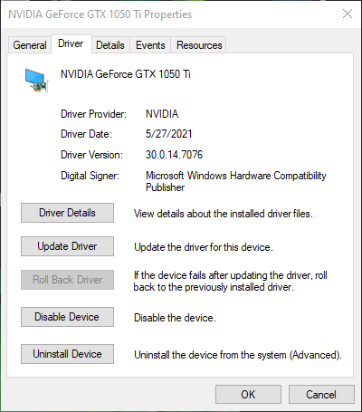

Could you tell me what your display adapter/driver are?
(Win+X, Device Manager, Display Adapters, Properties, Driver)
As a workaround, until we fix this, you can download the files (from Download Assets) and open them in QGIS? Those lines are not part of the images, they are an artifact of the viewer.
Video-driver

Can you get on a more recent driver?
You should be able to. It’s what it is meant to load, haha!
That is the most recent driver available, I’ve checked a number of times
Windows Update provided WHQL drivers are like, semi-LTS releases and oftentimes many months behind what the vendors release directly (which are also WHQL).
https://www.nvidia.com/Download/driverResults.aspx/176268/en-us
Thanks, downloading the latest driver now.
