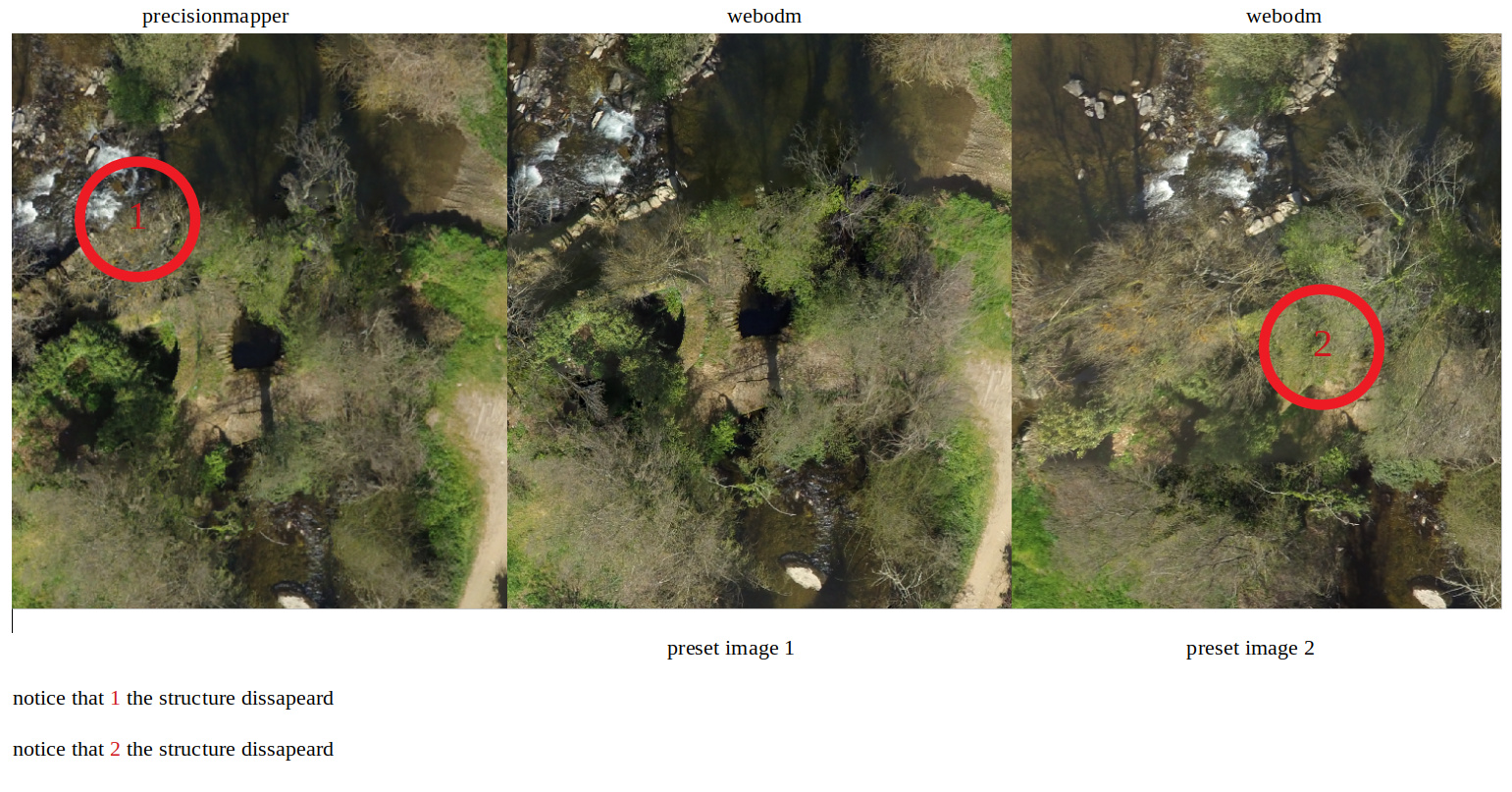

Anyway I insisted on changing some parameters in the presets, after looking at the changes made to the system ones that came standard with webodm.
In one tweak, the image comes out fairly nice but still has some issues in connecting treelines and waterlines.
On another tweak, the final image is awesome when compared to the ortho produced by precisionmapper, the treelines and waterlines were way better, but objects that were under the tree canopy dissapeared.

You have texturing-nadir-weight set to 32. Try lowering that if you’re missing things under the canopy. If you haven’t bought the ODM book yet, I’d recommend it - it covers this.

So I guess it’s possible the tweak the presets in such a way that I can have 2 for the generality of my tasks. One for 3d model and contours on the terrain, and another for plain orthophotography.
Yes, if you optimize for a better 3D model, it’s often at the expense of the ortho and vice versa.
