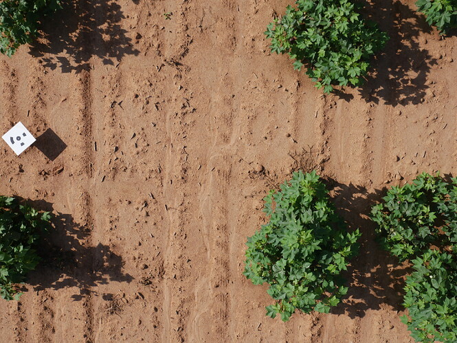

The complete output from ODM is provided. Attached are some example photos. I regret that I cannot provide all the photos because I am not authorized to share them publicly.
