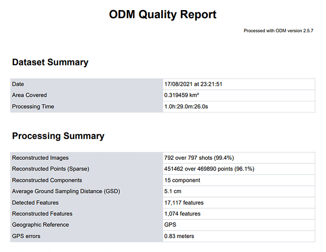

Hello everyone again! I just got done doing some drone flying the other day over one of our test plot fields. I am able to get it processed but it keeps processing at 5cm GSD when I flew at a resolution of 1.9cm GSD. The drone is a Phantom Pro 4 v2 flown at 225FT with 75% front and 75% side overlap. I am processing on the installer version on WebODM. The data set is 797 pictures.

Now I understand that PIX4D operates in a completely different way, but when I ran my set through it. It reported at 1.9CM GSD.
I am interested in knowing how to tell it the GSD you want? Is there anyone that would be able to help/explain this to me?
Here is a report snip of both programs

Returning an estimated GSD of 2.0, which is just about spot-on.
Thank you so much for that! Looks great! I am using the same settings you provided and still getting 5 GSD???
I am really confused about this. I attached a screen shot of my WebODM settings and the Quality Report.
Hmm… I’m using 2.6.1 via Lightning right now, so perhaps we’re missing a fix/change in the Windows 2.5.7 build at the moment?

Sounds good. I am re running it but with image resizing off to see if that changes anything.
YES!!! I turned off resizing images. Finally!!!
WebODM 2GSP|690x431
So turning resizing images off finally got you the GSD results you expected to see? I have been having similar problem, but wasn’t touching resizing images as it says somewhere in manual that resizing should not affect the final orthophoto quality. I guess it does?
From my experience it does, after turning off resizing, my GSD was right where I want it.
