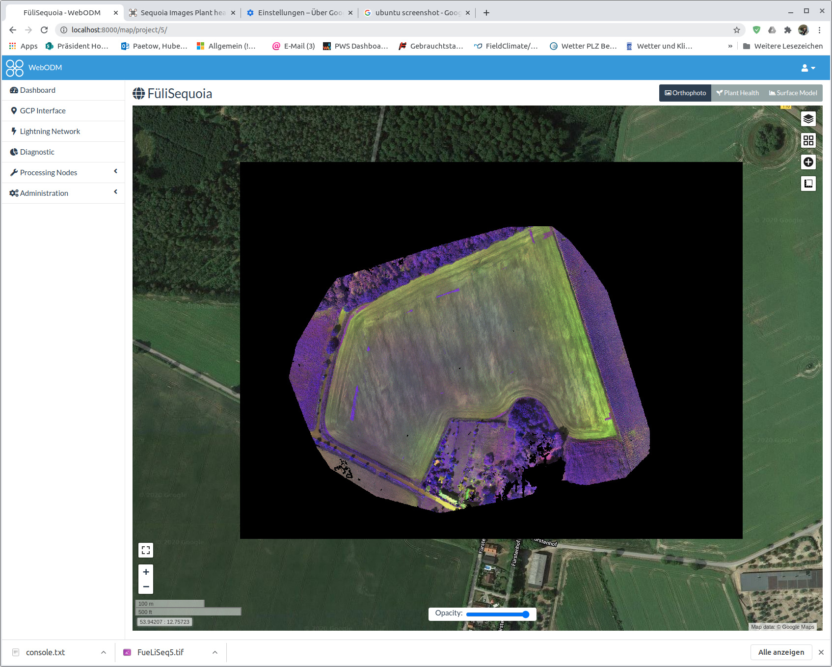

The GEOTIFF consists of 4 Bands - GRE/REB/NIR and an alpha channel. I can process the GEOTIFF in qgis and calculate the NDVI- Image.
But when i try to switch to “plant health” view in the webodm map, i get a message “bad request”. The process (webapp) message is:
WARNING Bad Request: /api/projects/5/tasks/58011f60-59a3-4124-af50-fc32a2a65e64/orthophoto/metadata
Any suggestions?

Perhaps a bug. Can you share the all.zip file from your task?
[Quite large]
(https://drive.google.com/file/d/150f-pUtw4f45dzNd8Xt3j-LvgOaEQprw/view?usp=sharing)
Definitely a bug. It should be resolved with https://github.com/OpenDroneMap/WebODM/pull/907
Wait a few hours, update, then see if the issue is resolved. :+1:
It works. Great.
Thanks a lot.
