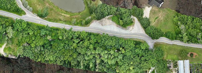

Any idea what would be causing the roads to come out super wavey in this image set? The trees come out near perfect but not sure what’s going on with the roads. Images captured from 300ft camera straight down M2P.
Land slips? :wink:
What settings are you using to process, and what overlaps did you have set for the imaging?
Having some non-nadir images in the mix often helps.
85% overlap done with just the fast ortho setting. Done in one pass so theres not side to side overlap but ive noticed the issue still exists in data sets with multiple passes.
Have you tried not using fast ortho?
Similar output, but now some holes in the roads…
What settings are you using?
