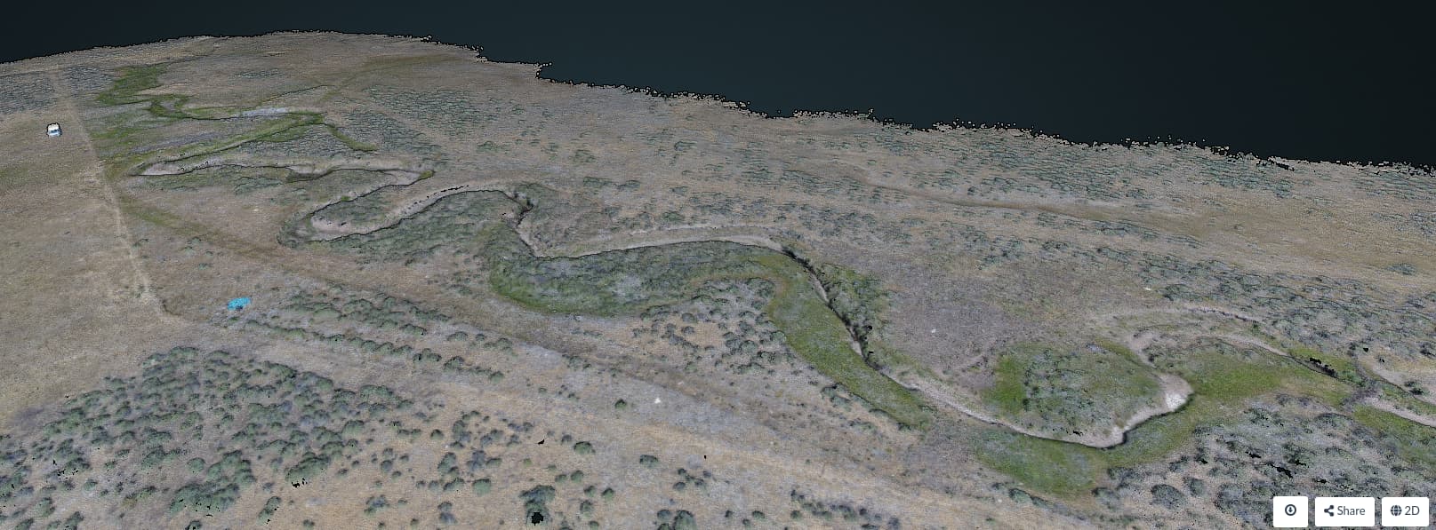

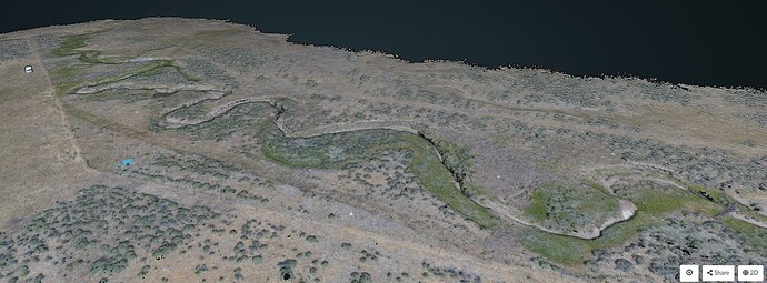

Looks pretty snazzy:
Yeah, it does look pretty good. The strange thing is I ran the project on my home computer using the same settings and it failed after 2.5 hours with the same error. My machine is considerably slower because I’m only using 4dimms out of 16. And, another difference is I use the --gpu upon startup. So, I’m rerunning the project now without the gpu and added another 4dimms yesterday. I also enabled IOMMU in my bios, which I have yet to fully understand how that might affect WebODM/docker-compose but I thought it was worth a shot.
Ahh, GPU vs. CPU. Those are totally different approaches under the hood. This explains much.
OK, It ran successfully without the --gpu. So why is the gpu causing it to fail? Other stats: It took 3:06, but the GSD was 1.03 vs the 2.77 on the spaceheater (why would the GSD be so different with the same parameters?), and mine produced 55mil pts vs the 60mil from yours.
