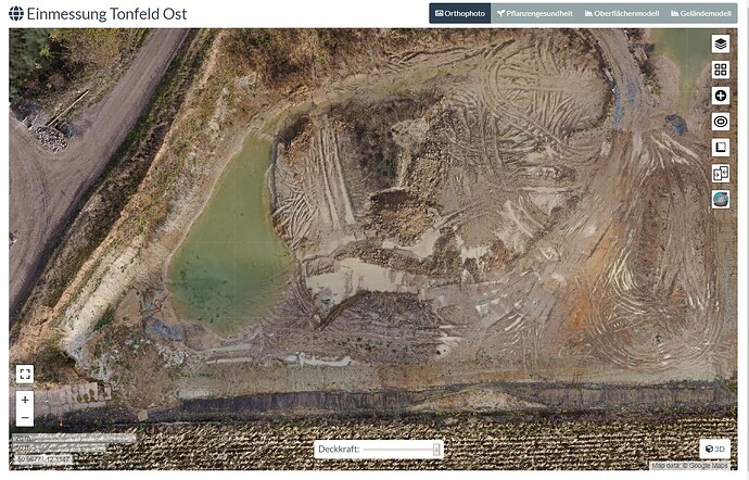

Hello community, I’ve done my calculation (auto boundary and pc tile true). Unfortunately I now have huge black tiles in my point cloud. how can that be? My pictures flew in with 80 80.
These problems with Webodm are very annoying as each recalculation costs me money.
I’m sorry you’re not getting the results you need.
Can you attach a screenshot?
If you’re worried about wasting credits, consider an unlimited plan. I’ve refunded you the credits for the task in the meanwhile.
Sometimes, the --pc-tile can introduce a bit of a seam into the point cloud, but it in general tends to not be terribly noticeable (if at all) in final products like the DSM.
Thank you for the refund. Below you will find the screenshots and parameters.

Thanks for the parameters. Maybe try raising --min-num-features a bit, --crop 0, and maybe remove --pc-tile?
You can also send me the dataset and I can try processing for you to determine if I can help solve the gaps in the middle of the stockpile there.
