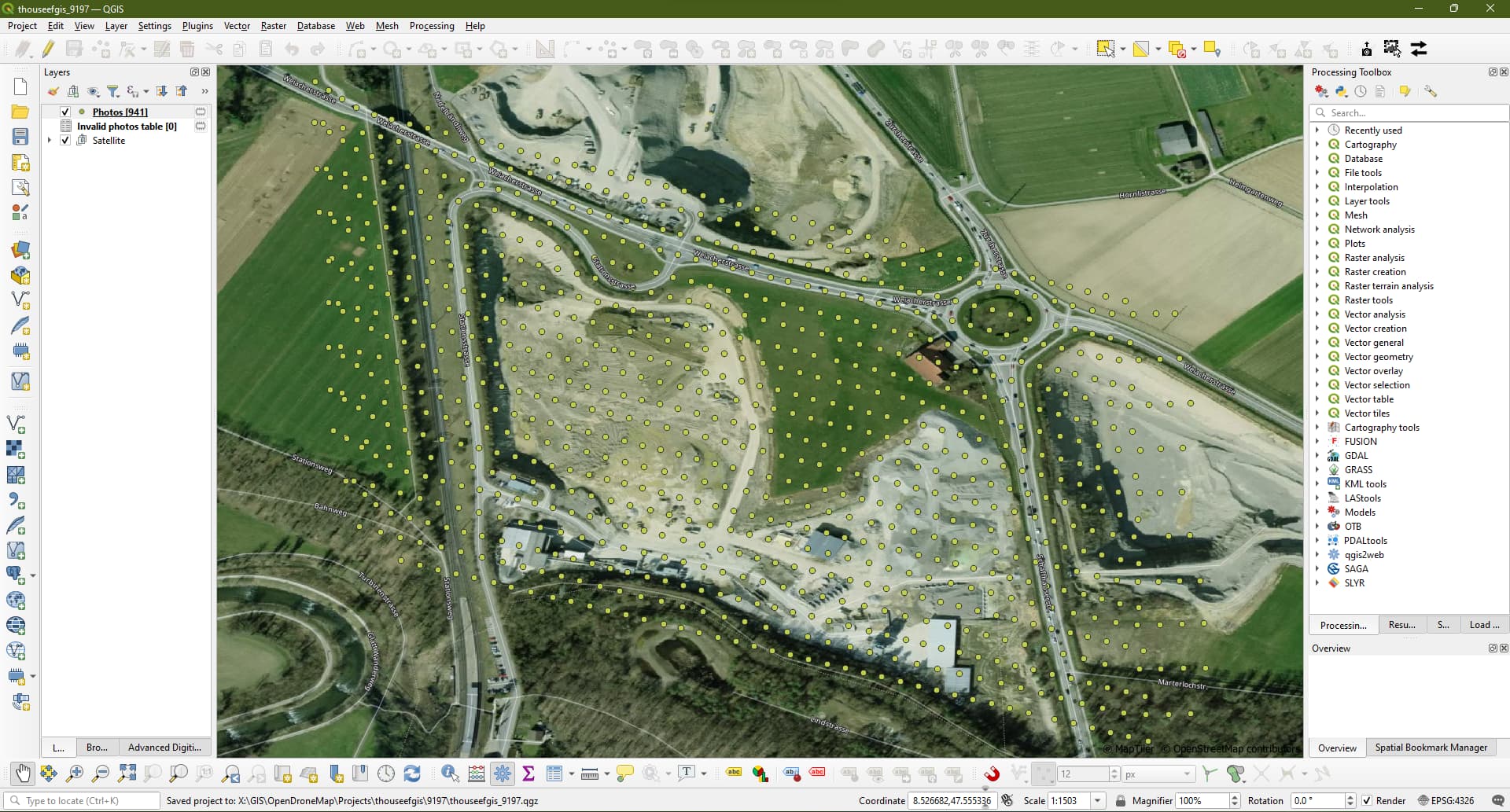

Looks like one of the images has corrupted EXIF data; do you have a copy of the full task log by chance (you can download that from the WebODM Lightning app), just find the task that failed, expand it and press the “On” button next to “Console Output”.
Agree with Piero that that log would be helpful. QGIS/GDAL didn’t throw any errors importing the photoset you uploaded to Google Drive, so knowing exactly what 43 images you used in Chunk_1 as well as what the log says is important.
