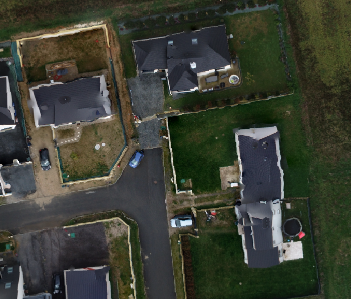

Here is a sample of the orthophoto. As you can see the houses have a lot of deformations. Is it possible to improve that ?
This is where the configuration fiddling starts. Short answer: yes it’s possible, but it will require some trial and error with the settings. A good place to start is running with the “brown” camera instead of the default. After you select your photos, click the gray box to the right of “Options” then scroll down to “camera lens”. Change it from “auto” to “brown”. As you experiment, I would use just a few (20?) photos which are closely grouped and have good overlap. Once you find some settings that are working, expand to a bigger photo set.
@Maneke I expect others here can also make suggestions based on the configuration you posted above. I’m still pretty new here, so personally not sure what to suggest beyond the brown camera.
What is your image overlap and what is the version of OpenDroneMap.
The overlap is 65% and the odm version is the latest
I thought maybe. For flying over buildings, I wouldn’t recommend such low overlap, as you don’t get enough perspectives to created a good orthophoniste.
