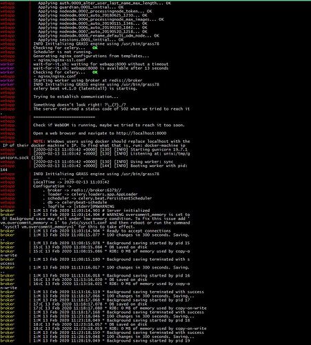

I enclose image copies of the newspaper

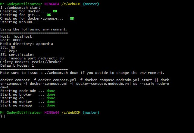

after uninstalling WebODM (deletion of the file and deletion of GuiWebODM) I wanted to redo an installation and I replied with a copy of the log image
WEBODM RELANCE
unable to start software and no connection
Your last log appears to have started successfully. What happens when you visit http://localhost:8000 in a browser?
when i want to open the browser page i come across a search page which shows me all the sites which uses the IP addresses ending in 8000
for the moment I have uninstalled everything PYTHON, DOCKER and WEBODM and made a system recovery. tomorrow I think to redo a complete installation and I will see if my installation problem will reproduce because I think that I did not have access to the good web page come because the installation is not done in full

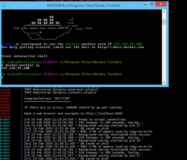

new test, it’s a little better but not yet perfect. I have a message that webodm should work, but when I try to open it with my browser it does not work
You need to put the URL into the address bar, not into Google search.
hello ITWarrior
I just tested your board even by putting the IP address in the google search bar, I get the same result I did the same test with IE and the result is always the same page.
I saw that we could test the docker connection but I don’t know the command line
