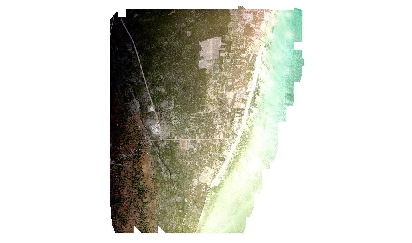

I’ve processed this orthophoto a few times and each time with different settings the lighting for the orthophoto is a gradient or just odd. Here is the latest:
https://drive.google.com/file/d/1G6G596DO1itPSQxCnJdpXuFXm0OkgEoi/view?usp=sharing
What settings can I change to avoid this? I know it is not an issue with images as they do not look like the output orthophoto and I’ve processed them before without this issue.
I took a screenshot so that other people don’t have to download the entire file:
There’s little you can tweak. This is a bug that has been reported and will be fixed as soon as Regularization by pierotofy · Pull Request #3 · OpenDroneMap/mvs-texturing · GitHub gets merged in.
You could pass --texturing-skip-global-seam-leveling temporarely to mitigate the issue, but you’ll get some color differences between the seams.

Ok new images are up! Please update and let us know if this is fixed. :sunny:
it is fixed! thank you guys you are the best!
In testing, it is much better, but still noticeable for a large enough dataset.
