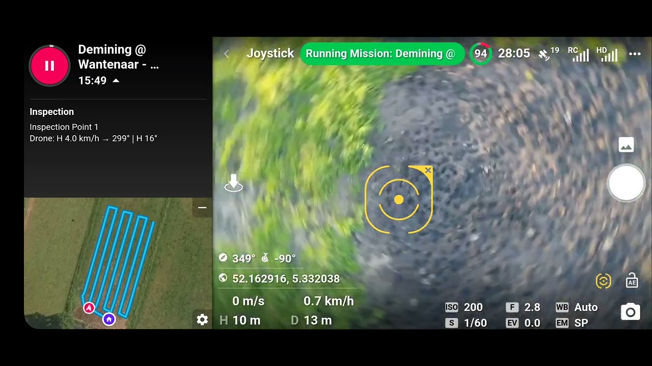

I believe I finally managed to produce decent images
Setting and flight:
and also create the Orthophoto using WebODM
Orthophoto:
Orthophoto as file and a couple of photos:
Behind the scenes:
Next step should be to fly again, but with the 3D printed mines in the field.
