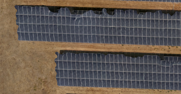

I am not a big specialist in the 3D reconstruction area and don’t know much. I am using WebODM for generating the orthophoto and 3D model from my data. It works fine, but orthophoto has lighted areas. Seems it is okay, because images also have lighted areas. But the texture model hasn’t lighted areas and looks much better.
My question is next: could I somehow combine textures from the texture model and orthophoto to create a better representation of the colors on the orthophoto?

Could you attach a few screenshots comparing the ortho and the pointcloud vs your textured model?
Screenshot from 2022-04-07 19-52-46
Hope this will be enough) I tried to screenshot the same area, but for texture model angle isn’t 90 degrees
