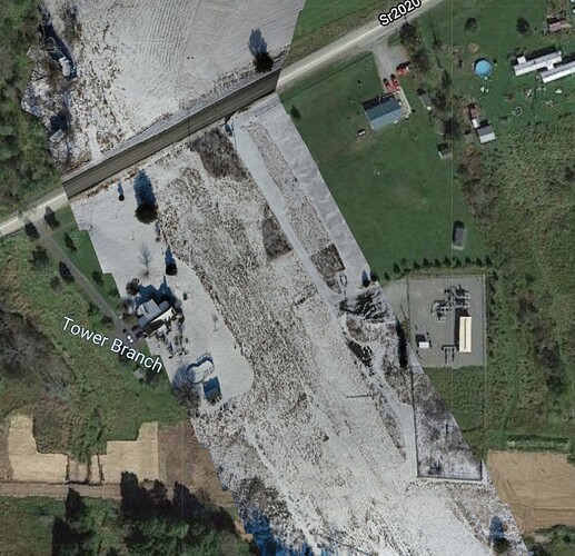

Ortho shifted and offset
Processed 145 Hasselblad nadir geo images from DJI.

The resulting ortho is always offset to left and by about 100 ft.
I ran odm on several other datasets in the same region, sometimes it is offset, sometimes it aligns well.
Ran comparison to Dronedeploy and Pix4d. They align the ortho perfectly. See images.
What am I doing wrong? Thank you for helping.
