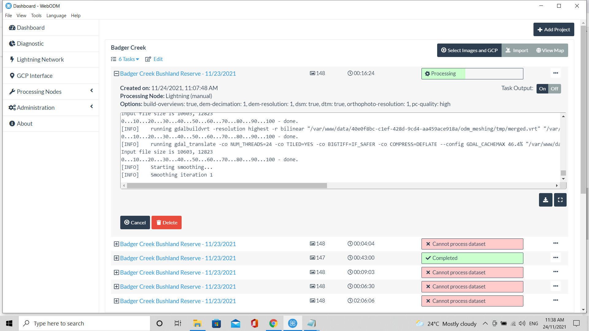

Been trying to process a relatively small dataset of 147 nadir photos and 5 GCPs with WebODM 1.9.7 on Windows 10 however it keeps crashing at the same point every time. Please see below screenshot and attached log file. Any idea how to fix this please?

I am tying to remove the problematic photos of GCPs from the text file and try again but here’s the latest log file of the failed process with WebODM:
Second log showing RuntimeError: Accessing invalid ShotID DJI_0658.JPG: Dropbox - console2.txt - Simplify your life
Third log showing RuntimeError: Accessing invalid ShotID DJI_0659.JPG
Looks like it has passed the point where it used to stop - fingers crossed :slight_smile:
Yayyy ! All good now … still learning a new thing everyday with WebODM :wink:
