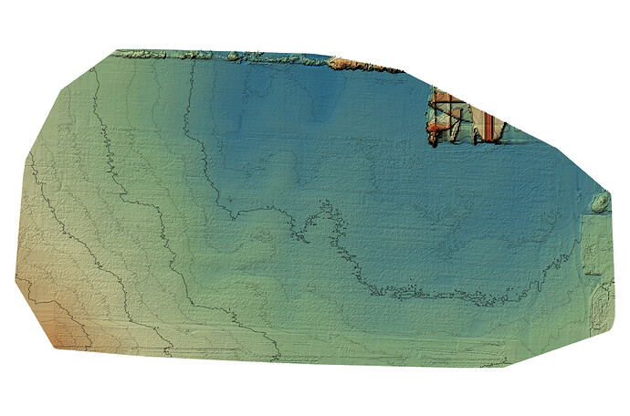

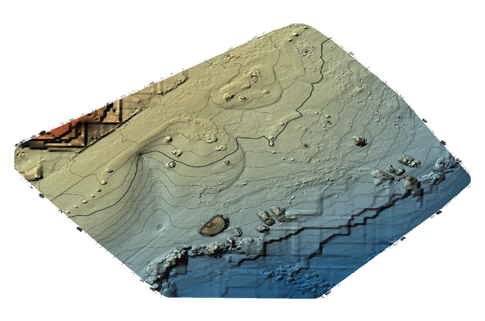

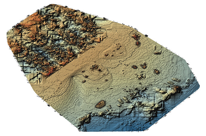

Processing Parameters (3D Mesh):
resize-to: -1
min-num-features: 80000
feature-quality: ultra
max-concurrency: 2
depthmap-resolution: 1280
opensfm-depthmap-method: BRUTE_FORCE
use-hybrid-bundle-adjustment: true
use-3dmesh: true
mesh-octree-depth: 12
pc-classify: true
dsm: true
dem-resolution: 1
orthophoto-resolution: 1
verbose: true
debug: true
gps-accuracy: 5
O’Brien’s Dataset [Terrain] - ODM 2.1.1

You can see the Bee-Boxes on the Southern edge of the field (even in the DSM)! The drainage channel my brother-in-law cut is also super visible. Heck, even that one stupid rock they can’t pull shows up on the DSM now! To me this is astounding, coming from a 12MP GoPro taken at 400ft AGL.
