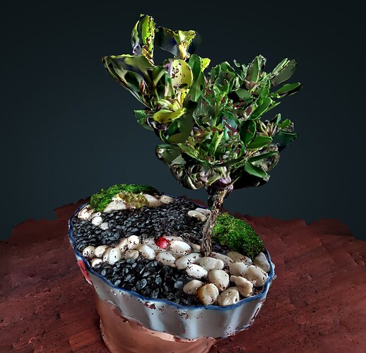

I was trying to improve the 3D model, which had incorrectly placed bits of textures and a few holes. I reduced GSD to 0.01 and increased Octree_depth to 13, and mesh size to 350000, which gave OOM

the 3D textured model is slightly worse with these settings:
||auto-boundary: true, dem-gapfill-steps: 4, feature-quality: ultra, mesh-octree-depth: 13, mesh-size: 350000, min-num-features: 13000, orthophoto-resolution: 0.03, pc-filter: 3, pc-quality: ultra, resize-to: -1, texturing-keep-unseen-faces: true, use-3dmesh: true, rerun-from: odm_dem|
|Area:|2,873.72 m²|
I saw that 235GB of memory was in use towards the end of the task, so it’s easy to see why I saw OOM with the GSD set to 0.01cm.
But I notice the area is still ridiculous- it’s a bonsai, not a huge tree!
Since you have no reference system on the input data, you can’t expect anything but a random size on the output. If you measure the model in those CC or meshlab, then you’ll have enough info to choose a sane orthophoto resolution. And, you can choose that sane resolution and then choose to rerun from orthophoto stage and save time.
