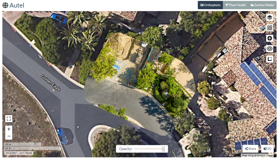

That did the trick! The settings were not that low, but I raised everything in docker.
Here are the instructions for anyone else having this problem!
