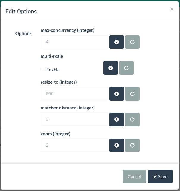

This is what I get …
oh ok, I get it, whatever option I choose, I get this:
