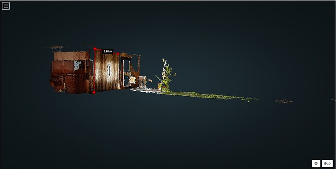

maybe the question is a bit silly, but I wanted to know whether I can create point clouds in WebODM with the Leica model mentioned above, for example. I have already tried it and have been able to create a fancy 3D model, but I fail because of the point cloud, so unfortunately no measurements are possible.

Point Cloud looks great, and measurements work.

This is weird, after you tested this, I switched browsers and everything actually works in Firefox. Chrome is currently causing problems with the model. Then one more question, can you tell me, if necessary, why the measurement of the scale does not fit?
Did you use Ground Control Points? If not, absolute scale may be off.
no, I have not used any ground control points, I am an absolute beginner and am still testing WebODM.
