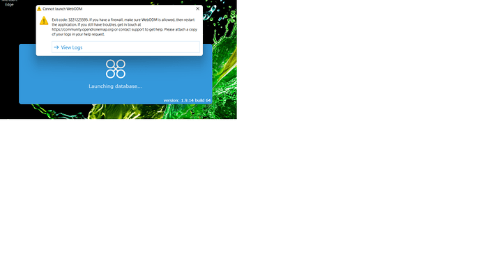

Have recently installed but failing to run the WebODM - I have updated my Firewall settings to allow the programme to run to no avail. Log is as shown:

Good Afternoon,
  1. Windows 11 Home
  2. 8GB RAM, Intel i5 10210U CPU, Aspire 5
  3. Native Installer (followed Web Link to download)
  4. WebODM Version 1.9.14 Build 64
  5. Assume Automatic
  6. Attached
