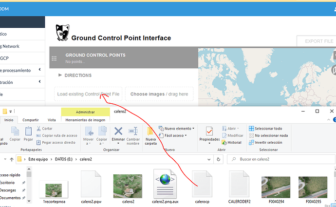

do a txt file with notepad or another text writter with 5 gcps as ODM bible said
drag to the webodm gcps menu
load images, 3 minimun, of one gcp s
be aware to clean and erase the brown points that appear only when both points are green is ok
