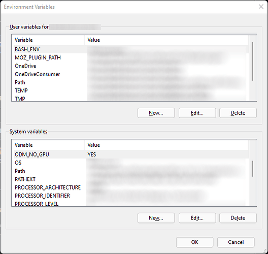

You can set an Environment Variable:
ODM_NO_GPU=YES
For me, I’ve chosen System-wide (System variables).
You make a New one and then set the parameters:
To Edit your environment variables, search for edit the system environment variables
in your Windows Start Menu:
Then click on the Environment Variables button towards the bottom:

That’s not a good way to do it, better make a setting in the software.
This is the supported method at the moment and it aligns with what we do on Linux/Docker.
I agree that we can improve the UX, but this should work for your needs for the time being.
