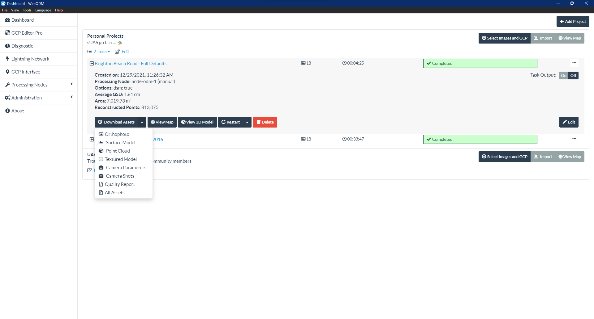

**please excuse my ignorance. How do you get the completed maps from webODM to something that can be shared as a file. I have maps inside the program but can’t figure how to save in format that can be shared with customers. Thanks
You need to download it. There’s a button once it completes. If you say map you probably want orthophoto. Jpeg works everywhere and WGS80 so it has same coordinate system as Google maps and similar.
Marko gave you a great starter!
If you expand your Task(s) under your project, you’ll see the Download Assets button:
If you go to View Map for a task, and click the Layers button on the right, you can choose different export formats and projections:
(More on that here):
Let us know if you need any other guidance!
