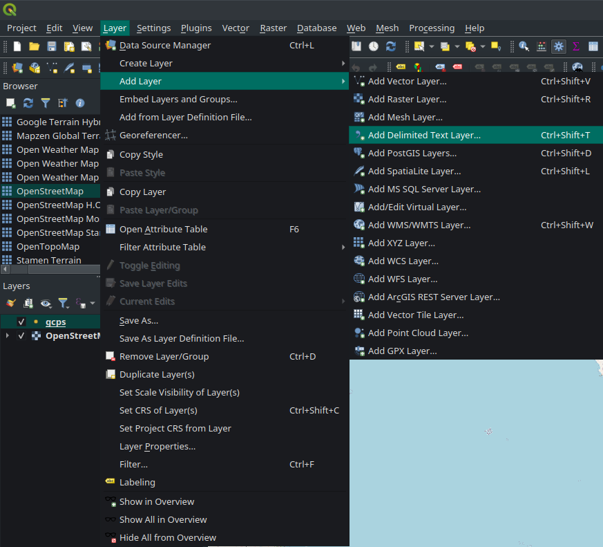

I’ve been playing around with QGIS and trying to locate your shared points. However, I noticed that the CRS (Coordinate Reference System) might not be quite right (I tried 36N and 36S [UTM/WGS84]). I’m not sure if you’re working near the Antarctic or southern Egypt, but it might be worth double-checking with the surveyor to make sure everything is accurate.
I’ve attached some screenshots of the results and a quick guide on how to map GCPs on QGIS.
Results of CRS: WGS84 UTM 36S → somewhere near the Antarctic
Results of CRS: WGS84 UTM 36N → somewhere south Egypt
How to map GCPs on QGIS?
  • Save your points in a file (.csv, .txt, …)
  • Add a new layer on QGIS
  • Manage your data
      1. Add the specific delimiter, in this case I used a <space>
      1. Choose the fields (I kept the defaults - not real fields names)
      1. Choose your Coordinate Reference System
