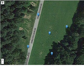

GCP Editor pro: (sorry, deleted the generated data but it was a few meters off too)

It looks like we have a difference in basemap. We’re using Google Earth for our basemap. Pix4D looks like VirtualGlobe/Bing, and Carlson looks like possibly ESRI.
I’ve found in past work that Bing is far more accurate compared to Google Earth, but often of a lower resolution (spatially and temporally).
This is where being able to specify a custom WMS/TMS for basemaps might be useful.
