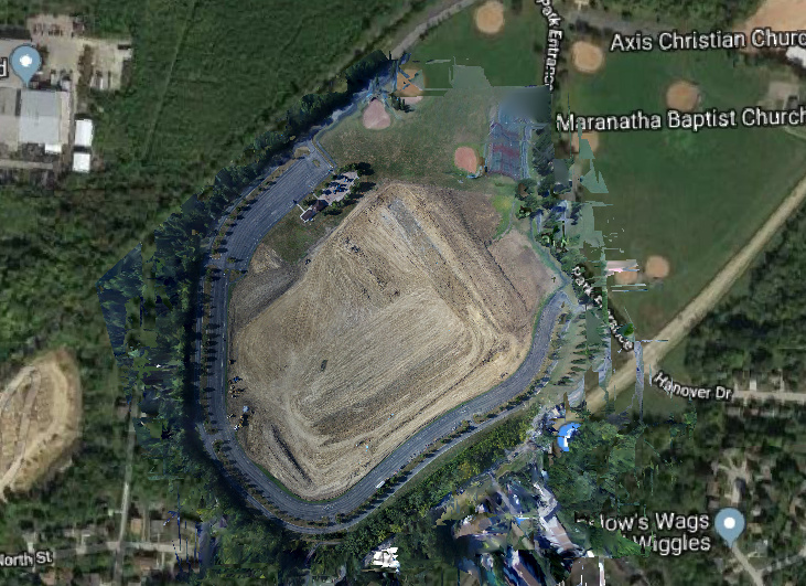

Hey @todd45040 :hand: I’ve been able to process it until the end without errors, but something looks really off with the point cloud (and all subsequent outputs):
Looking at the images I’m guessing that ODM is unable to compensate for the fisheye distortion (an inspection of the camera model also shows that the camera is wrongly classified as perspective instead of fisheye).
Admittedly this needs to be improved (I’ve opened an issue here Allow users to manually specify (override) the default camera model projection_type · Issue #1018 · OpenDroneMap/ODM · GitHub). In the meanwhile, I would recommend trying to undistort the images manually with a software such as Rawtherapee before using them as input to OpenDroneMap. https://rawtherapee.com/
So I got really intrigued by this dataset, and with the latest changes in Upgraded opensfm code, added new deps by pierotofy · Pull Request #1015 · OpenDroneMap/ODM · GitHub and passing --camera-model fisheye (available only in that dev branch) I was able to process this dataset quite nicely!
Point cloud:
Ortho:
Made the results available here: https://drive.google.com/drive/folders/1H37KO2xGKGnKg3_mMGwEY48YZiXqO2Ib
These changes will probably get merged and be available in WebODM in a few weeks as they need some more testing (people are welcome to rebuild the docker images from that branch and do tests however). :+1:
