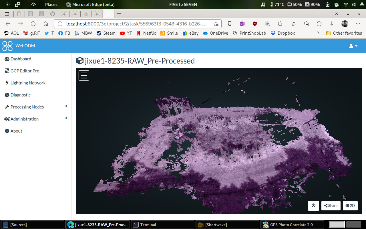

So, I think it might have to do with two of your images having completely insane GPS values, and making the processing extent unsolvable.
157.TIF and 167.TIF (158.JPG and 168.JPG in the original/RAW) are showing up across the ocean off the Eastern coast of Spain.
I’m re-running with these erroneous images removed now:

Yes, two images had very wrong longitude values, putting them half a world away. This makes the reconstruction extent extremely large.
Fixing these values, or removing the bad images, is all that was required.
I would guess faulty GPS and/or buggy firmware causing the wrong values to be written to the images. I don’t think it was their pre-processing software as the original images (RAW+JPG) dataset also has this problem.
I don’t normally pre-check image locations, but I will from now on.
