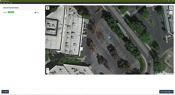

Something might be amiss with the GCPs, as I received the same error as you when processing using them.
How did you prepare the GCP file?
Yep, pretty sure your survey wasn’t in the South-Pacific Ocean:
Much better when using EPSG:32610 (WGS 84 / UTM zone 10N, not South)
