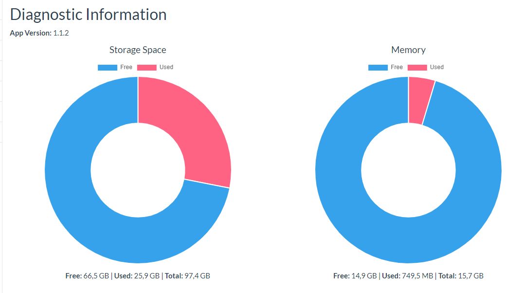

Second, what version of ODM are you using? How are you running it? You can check the version on the Diagnostic section on the left.
Hi, here a there files.
And the version is 1.1.2
