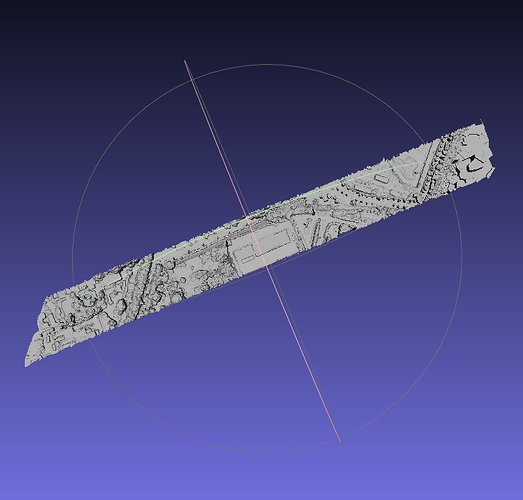

Hello, everyone! I describe in detail some of my attempts and problems. Firstly, I used the “dem2mesh” to create “odm_25dmesh.ply” for the “mesh_dsm.tif”. Like this:

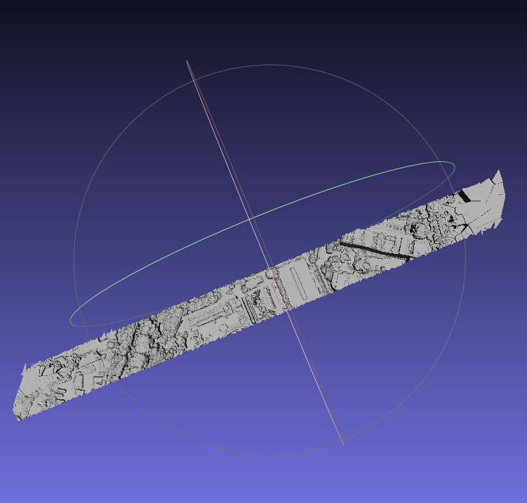

Because the entire mesh is too large and the number of images is 300, resulting in insufficient memory crash when “texrecon” calculates the texture map for “odm_25dmesh.ply”. Then I divided the “odm_25dmesh.ply” into several tiles. Like tihs:
These mesh tiles are a whole mesh(odm_25dmesh.ply) in meshlab.

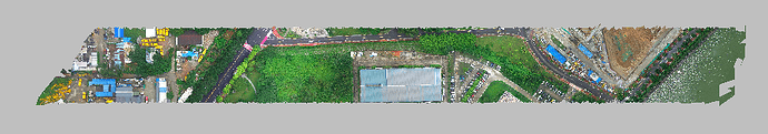

I used the “texrecon” to calculate the texture mapping of each mesh tile separately. Like this:
These texture tiles are a whole in meshlab. Like:
Finally, I used “odm_orthophoto” to calculate the orthophoto for each texture tile separately. Like this:

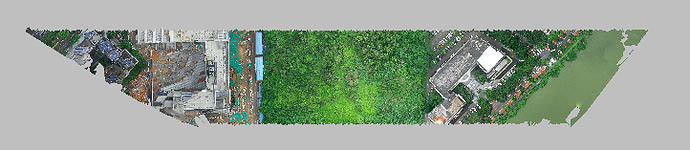

I merges these orthophoto tiles into one whole. Like this:
But this whole orthophoto has some errors. There are some holes between the orthophoto tiles. The gap is about a pixel size. Like this:
