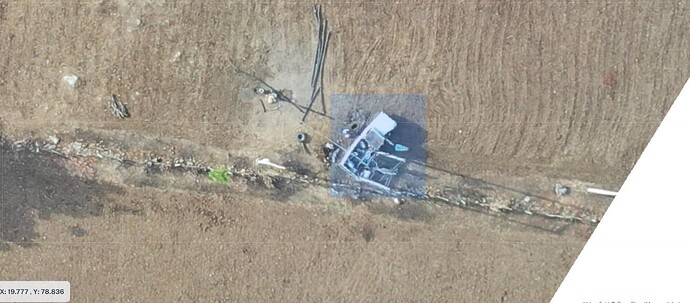

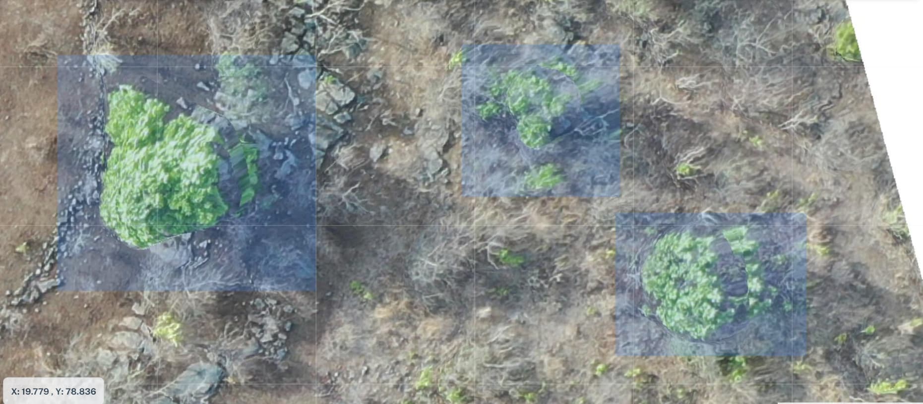

I’ve been experimenting to find the perfect combination for generating orthophotos comparable to professional software. As you can see in the pictures above, I got decent results but there are some distortions and blurriness around vegetation and man-made objects(Point of interest are highlighted with translucent blue boxes). If anyone wants the orthophoto, here’s the link.

Trees move around if there is any wind at all, so often come out blurry. Structures usually benefit from extra coverage from non-nadir angles, and pc_geometric is helpful with square edges/straight lines in buildings and machinery.
Thanks! I didn’t consider the wind factor :blush:

  2. Despite using pc-geometric, there’s still some distortion in the structure highlighted in the first screenshot. How can I get rid of that?
