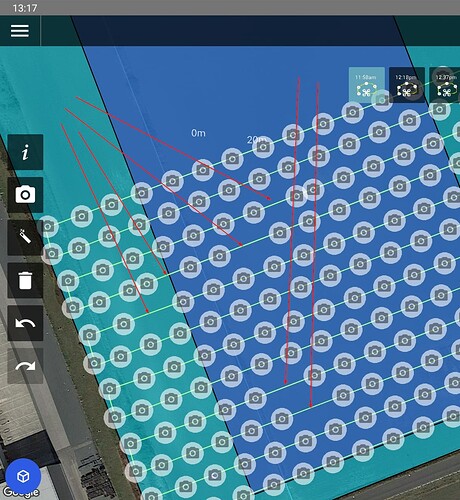

If you are using a flight planner, this is what I was seeing when you don’t have enough coverage. Please note the lack of photographs taken. So I went back right after and made some pictures where the holes were:
Isn’t that for cameras that don’t get calibrated? You can still have coverage/reconstruction in those areas, and vice-versa, you can have every camera calibrate and be part of the reconstruction and still be missing areas in the reconstruction :grimacing:
