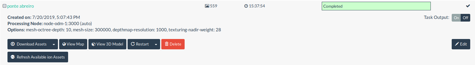

Just wanting to share the latest process of 559 images, taken in a grid fashion, 80º angle on the camera, and 85% side and front overlap.
A kickass 15 hours to process and an awesome result using “building” setting.
Thanks for all the help!

Well the hardware has to be taken to its limits … i’ve processed only one of the runs (north/south i think) and compared to the two runs on the original process. It seems that when ever possible, always photograph on both orientations. The model gets much richer in detail.
Can you show the parameters and settings of the task?
Just processed with standard “building” settings … i’ve stopped fidgeting with the settings for now.
For capture, two flights were done, one North/South at 50m with the gimble at 80º, and the second, East/West at 50m and gimble at 80º. Overlapping was at 85% front and sideways on both flights.
