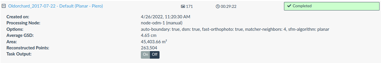

Can you give us an idea of what your Task is like?
For instance:
Created on:	4/26/2022, 11:20:30 AM
Processing Node:	node-odm-1 (manual)
Options:	auto-boundary: true, dsm: true, fast-orthophoto: true, matcher-neighbors: 4, sfm-algorithm: planar
Average GSD:	4.65 cm
Area:	45,403.66 m²
Reconstructed Points:	263,504

The Contours are generated on-the-fly via the View Map function, so they won’t be anywhere to download until they have fully generated, then you export them from the Contours plugin:
I would try maybe setting the interval to something like 30m and simplification to 30m and it should generate quite quickly. If that works, then we know the other settings are just too fine and it is taking a really long time to generate.
It worked!
interval 10m (entire model including trees is 37m height), smoothing 10m
it took 5mn
So I guess, for smaller intervals, I should do EITHER Preview OR Export, and wait for one to finish before trying the other
Thank you Saijin!
Just one more thing,
How do you stop or cancel a contours operation thats taking too long? (small interval and simplification)
I’ve tried closing WebODM but a process “Grass” remains running in the background
Just force stop Grass?
Yep! Until we figure out how to get this more parallel, it will take a while. If speed is of the utmost importance, you can always generate contours in QGIS.
:grimacing: Unfortunately, that’s the best answer I know of at the moment.
