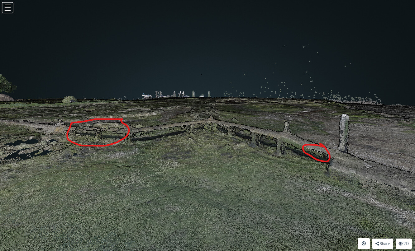

Reran the 2021 dataset with these settings…
dem-resolution: 1.0, dsm: true, feature-quality: ultra, ignore-gsd: true, min-num-features: 12000, orthophoto-resolution: 1.0, pc-quality: ultra
Still struggles a bit with some of the circled features, but much better than I got originally, and this isn’t actually in the main interest area, so can live with it!
